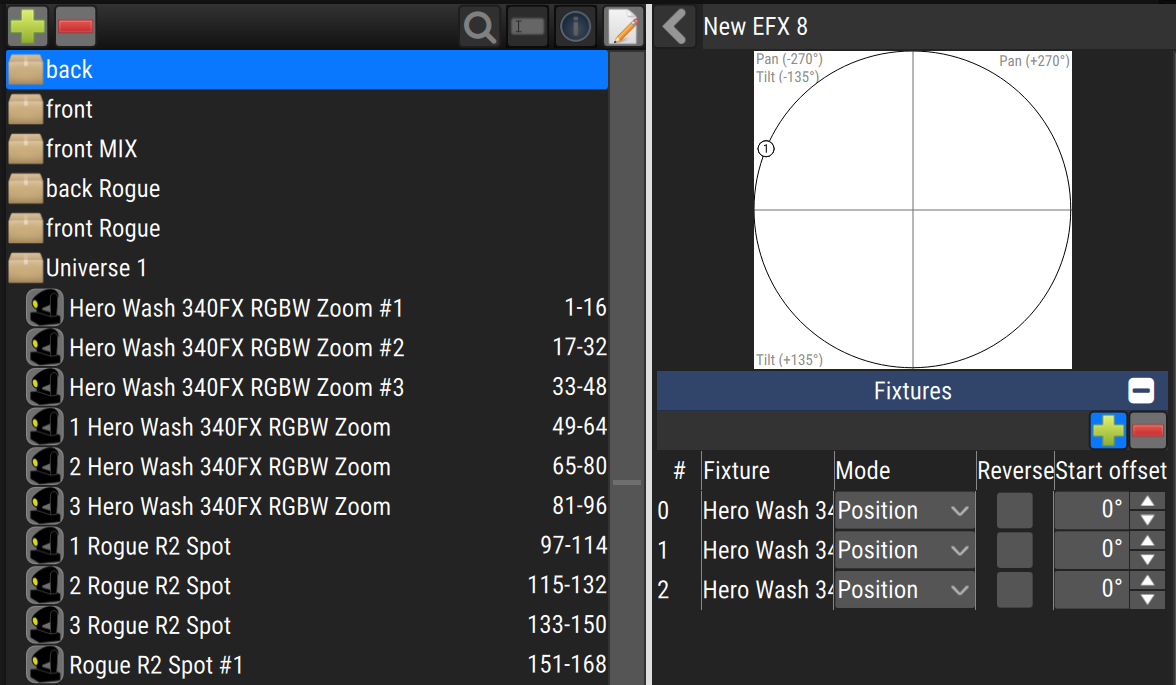

for now only scenes and RGB matrix can refer directly to groups.
EFX:
we should update the EFX to refer also to groups and of course tell the EFX how to spread/offset the group.
Right now when you add a group it exposes the fixtures (as when you record a scene from the 2D View).
EFX:
