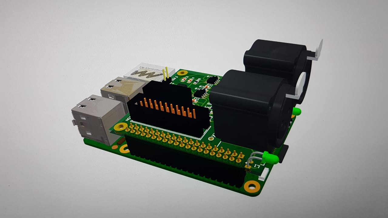

With that new functionalities, i move on desinging and building a custom RASPBERRY PI DMX HAT with the following characteristics:
* 2 XLR Neutrik Outputs with splitter
* Galvanical and Optical isolation
* Dedicated fan power pins
* Reduce size and heigh
* Status LED for each output
* Extension of GPIO Pins
The first wave of baords will be ready in two weeks!!

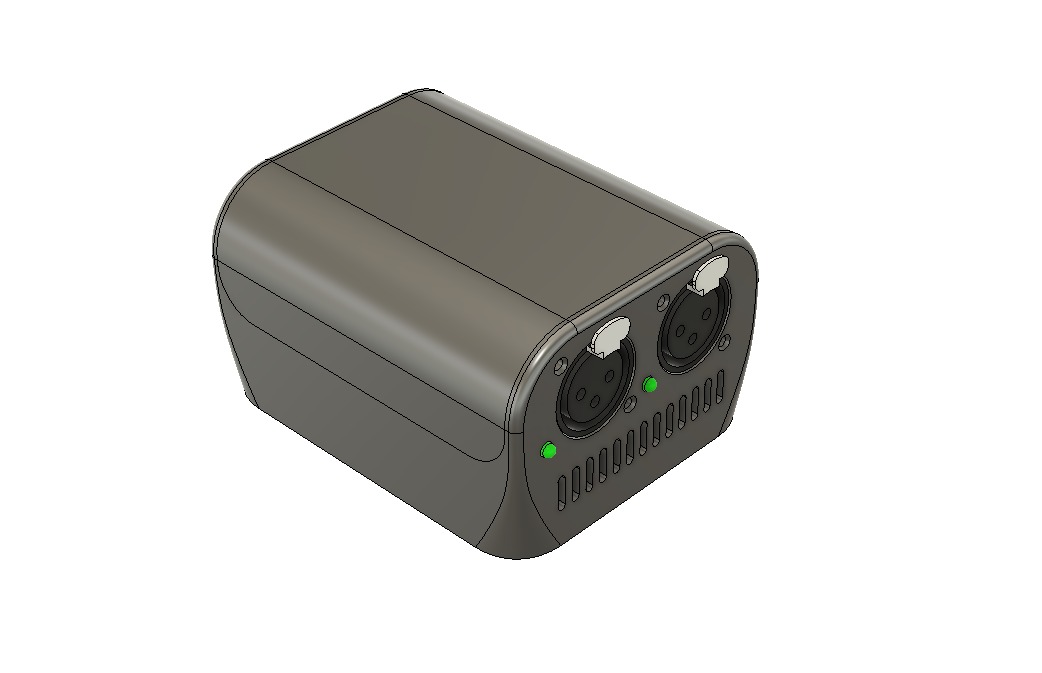

With the new board, the challenge of a case came up inmediatly so i decided to start with the desing of a custom 3d case for the RPI + DMX HAT. The case is in the last iteration of design and will be ready to print in to weeks too.
I called my proyect L4e - DMX LIGHTSPOT because it can work standalone with QLC+ controlled via CELLPHONE or TABLET or could be set to work as an ARNET INTERFACE.

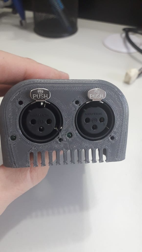

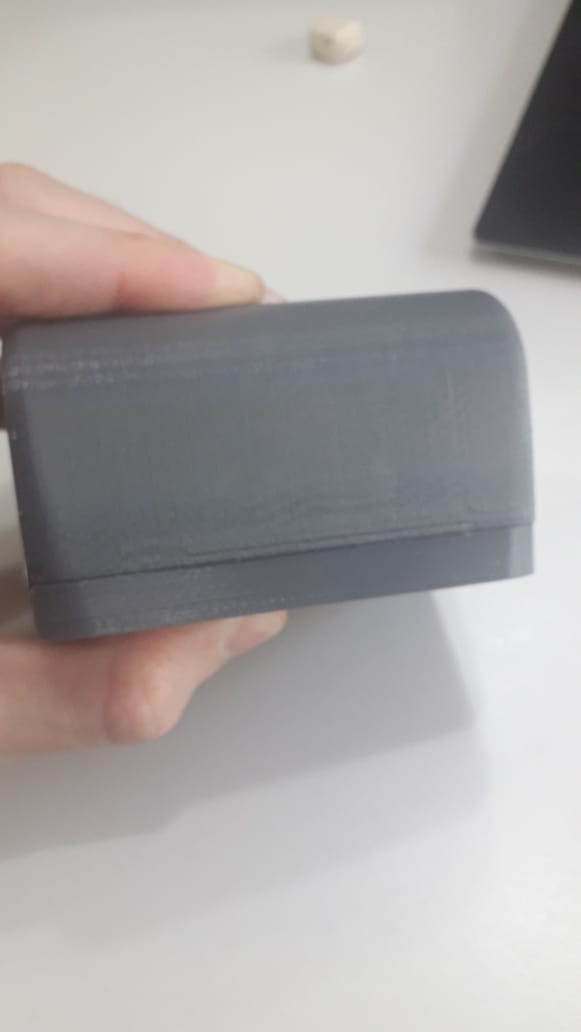

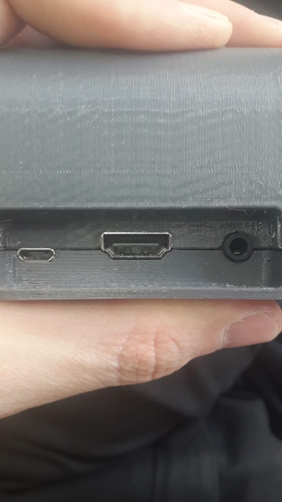

Well, finally we have some action with this project.... after a few weeks from my posting, the first group of hats were delivered and ready to start being used!
With the board in my hands, we started to print samples of the enclosure and make some adjustments
alanle
Posts: 13
Joined: Thu Sep 26, 2019 3:54 am
Real Name: Alan Lechmann
A few hours later, everything seems to fit better
Looks like we have our first interface assembled and ready to start runing some testings

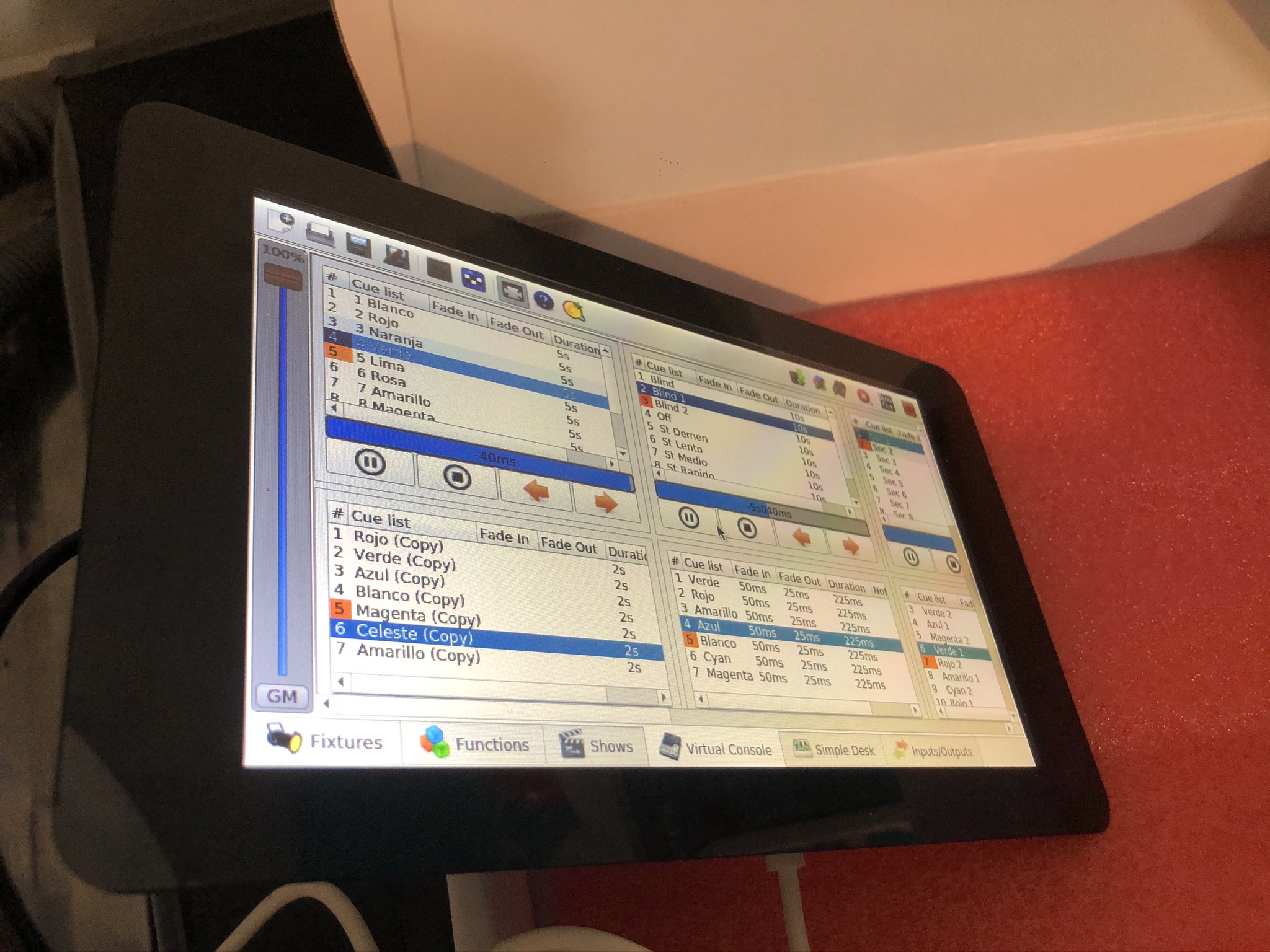

“If the Mountain won't go to Mohammed, then Mohammed must come to the Mountain“
40 fixtures with more than 400 channelsusing efxs, chasers, timmers... running 24/7 with no need to restart or issue!!
That week was a little bit boring so we made some progress on phase 2 (custom midi controller) and 3 (TouchScreen)
To be continue...
