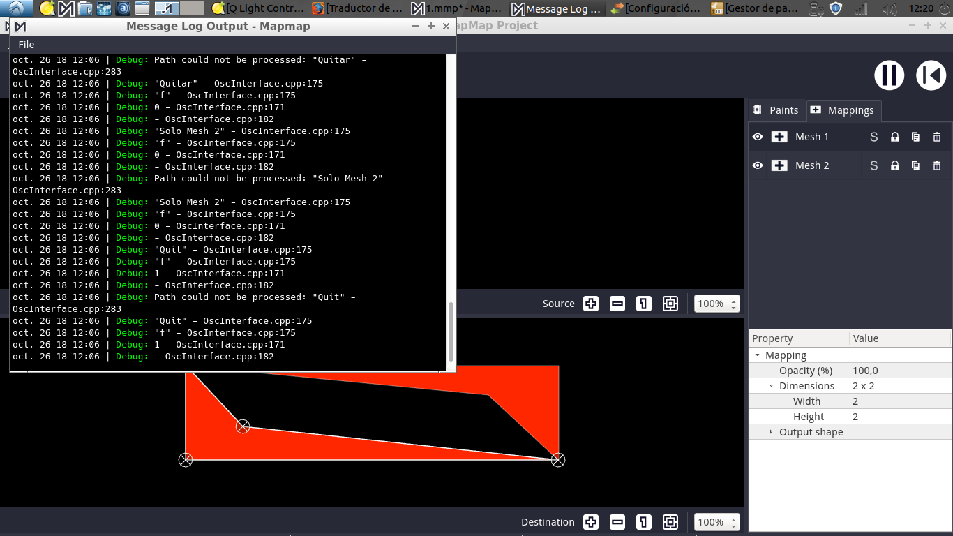

Hello again, in the end I got it, MapMap receives orders from QLC + through OSC,
Attached photo with configuration in inputs / outputs, I just have to finish the profile properly and I think it will work. Thank you very much for the help and the clarifications, if I can create a profile that works correctly I will share it in case it can be useful.
Thank you so much for everything.

Hi all!! And finally I got it !! this is wonderful....
After hundreds of configurations and modifications in the OSC profile, I only managed to execute 4 basic commands and they worked ... (play, pause, rewind ..)
Which discouraged me a lot ... seemed that mapmap did not understand the orders ...
I tried to contact the mapmap developers to try to find a solution, and they kindly offered to help me and give me the information I needed ... special thanks to Alexandre Quessy
In the end I discovered a method to send OSC commands by script, I only needed some extra libraries:
The txosc library for python. It contains osc-send
* The oscsend utility
* The liblo C library
In this way I can fully control the video projection or videomapping with QLC +.
I share the profile for mapmap and the project that I'm creating for a music group with which I'm a sound technician and sometimes I take
some lights and a projector .....
The profile at the end is not necessary, although it would be another functional solution, but only a few commands work ... I share it in case someone needs it, and the project I share it in case someone wants to see the structure of the OSC messages using a script system, in this way you can control any application that receives OSC commands .....
a greeting
a greeting
