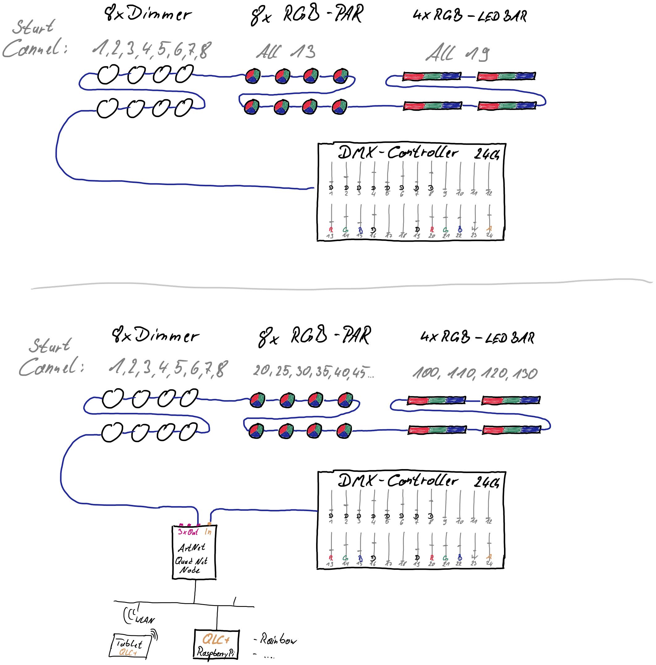

Hi GGGss, thanks for the reply and inquiry.
I have outlined what we have today and what I would like to set up.
Since our DMX controller can't control every RGB light we are very limited in the light show.
To keep the usual DMX controller for all volunteers I want to put QLC+ on a Raspberry Pi and Quad Net Node in between. On special occasions, a private tablet should then be used to start a rainbow running light, for example.
Unfortunately the DMX-In function on the Quad Net Node breaks down as soon as I activate the input in QLC+.

Frank,
Thank you for your well-drawn sketches
Nice.

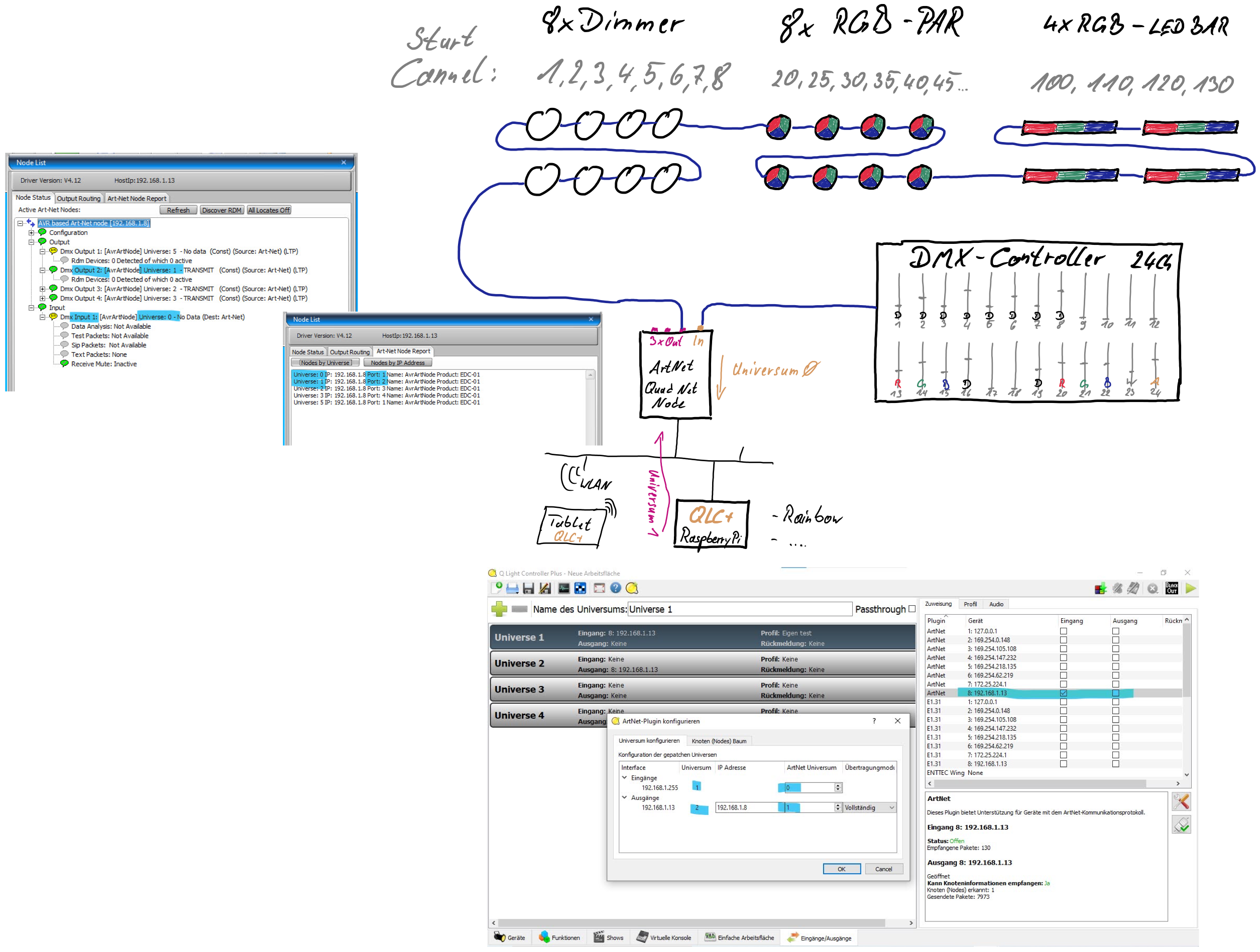

hi, I have changed the output in QLC+ to Universe 4 (ArtNet 3), unfortunately without success
The screenshot in the sketch are from DMX-Workshop
On another PC I watch the ArtNet with ArtNetView (https://artnetview.com/).
It's as if a "collision" or a "bad IP packet" kills the DMX-In ArtNet communication of the Quad Net Node....
my IP network is 192.168.1.0 netmask 255.255.255.0
Quad Net Node = 192.168.1.8
QLC+ PC = 192.168.1.13
The Quad Net Node can, according to the manufacturer, not be changed to e.g. 192.168.1.13 for DMX-In, it always sends to the broadcast address 192.168.1.255.
If at all the Quad Net Node sends the data at DMX-In from the DMX controller only very short via ArtNet.
Also the
symbol in QLC+ does not appear then any more...
Also the

Hi scarffac3,
yes, with DMX Workshop everything works.
But if I start QLC+ or PC-Dimmer no DMX-In ArtNet packets are displayed in Wireshark and ArtNetView anymore
