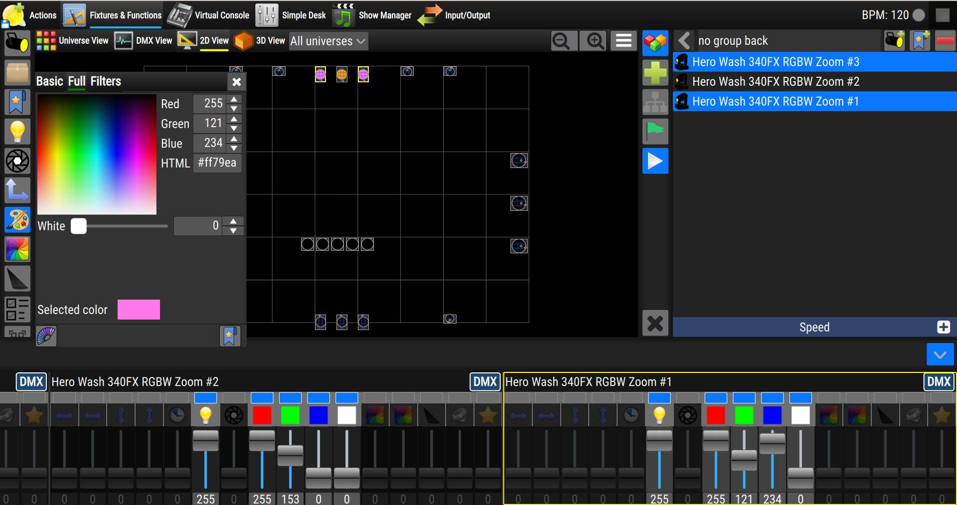

hi guys, I've found a partial workaround for v.5:
when editing a scene, you've to select all the fixtures that you want to copy, on linux with CTRL click, then in 2D you can control globally the parameters exposed by the widgets.
Unfortunately many parameters are not reachable in this way but it's already something and you can also play the scene while doing the changes.
It would be good to have a copy command for fixtures in 2D view to use not only for editing.
On the contrary, when you modify a parameter with the slider in the scene fixture list, the corresponding widget won't update to the actual value, it's been already reported.
