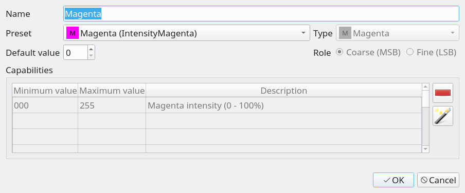

Channel presets
This is most likely a big shortcut when creating a definition. Think for example of those LED bars with 32 RGBW channels.
To pass the fixture validator you had to set the channel name, the channel group, add a capability and give it a description.
With presets, you just select an item from a combo box and the whole channel is set automatically with all the correct information.
Screenshot:
But channel presets are not just that. There are presets like "Pan/Tilt speed (fast to slow)" that will indicate exactly multiple things:
- the channel is a speed channel
- it affects Pan and Tilt
- it goes from fast to slow
All with just one click !

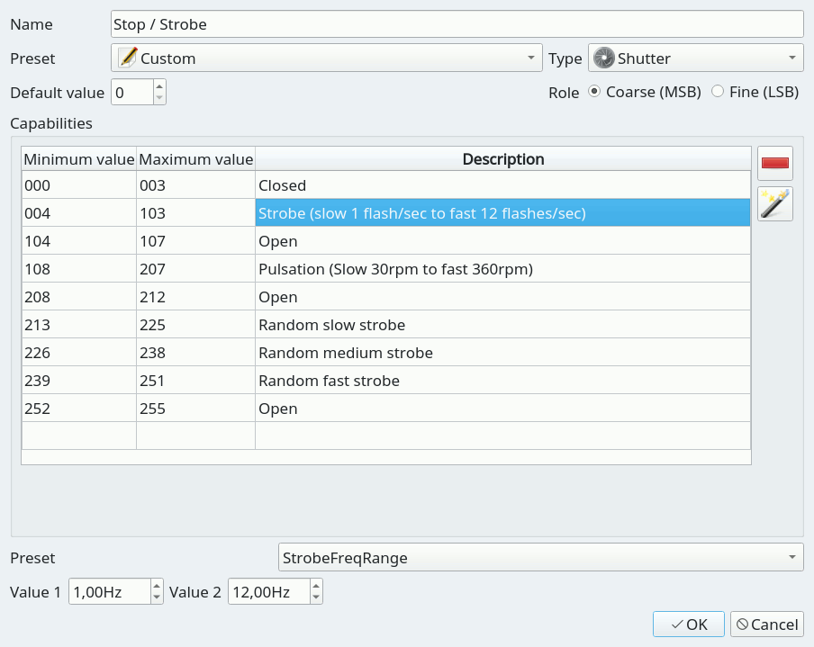

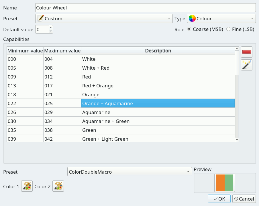

Capability presets
This is probably the most interesting part of the whole rework. And it really leaves space to future improvements.
Something primitive was there for color and gobo capabilities. You could set a color or a picture, and QLC+ knew what to do.
However, more complex channels like shutter, usually have several capabilities with totally different meanings.
So, capabilities now have a list of presets to exactly specify the meaning of a capability.
Some presets are specific to a channel type (e.g. shutter), but some other have been left generic.
For example, a "rotation" presets in combination with the channel type (e.g. gobo), tells QLC+ exactly what to do (e.g. a gobo picture should start rotating)
Screenshots:

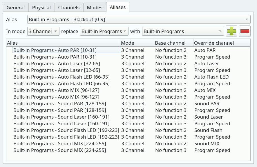

Aliases
And this is the most wanted feature ever asked: interdependent channels !
This covers the need of channels changing their meaning depending on other channel values.
Therefore a capability preset called "Alias" has been introduced to address this need.
Once an alias has been set, it is possible to define which channel has to be replaced and in which mode.
Please refer to the updated documentation to understand how this works. There's a practical example too.
Screenshot:
Aliases are just a visual aspect, they don't really matter to what DMX value goes out on which DMX channel, unless you are replacing a LTP channel with a HTP channel.
Visually, you can achieve things like this:
