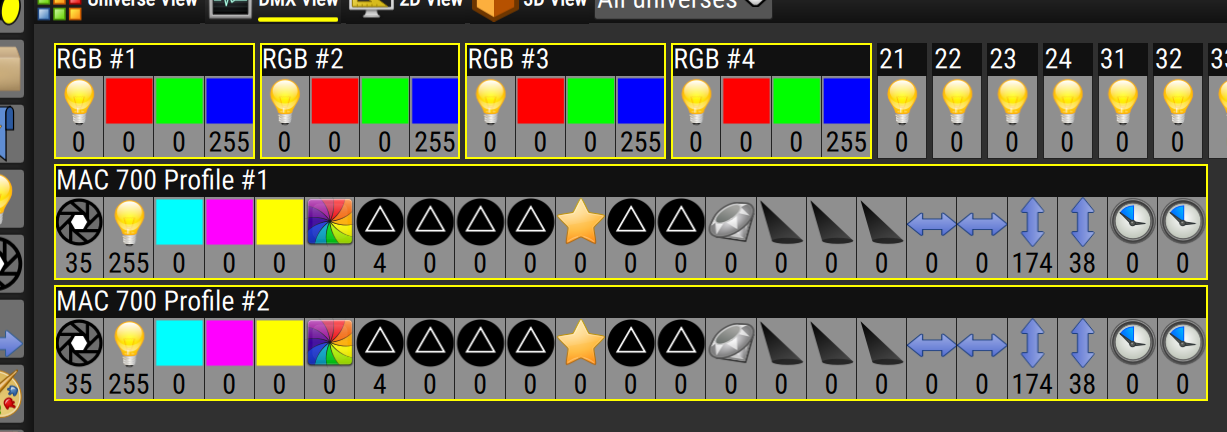

Maybe an idea:
in Dmx View or 2D View it's already present the output of the scenes being played in Virtual Console but the function "Dump on a new Scene" gets activated only for the channels that are modified.
I was thinking that we could add a new function like "make all the channels active" for the selected fixtures, in Dmx View or 2D View,
then like usually use the "Dump on a new Scene" button again.
At least this seems a simple and fast way to dump the output.
We can later deactivate the channels not needed in the scene properties.
Not sure if It should dumps values from Simple Desk as well. it's useful to have an independent section.

@ Massimo,
when you say like v.4 you mean as well the v.4 widget?
v.4 dump is versatile but super frustrating - for me, I would prefer to do these operations, at any time, directly in the 2D View.
As written above, 2D View is already monitoring the output so I was thinking about a function like "Make Channels Active" for the selected fixtures.
"Make Channels Active" would correspond to select all the channels of a fixture in v.4 Dump.
Then we will use the "Dump on a new Scene" as usual > > where you can filter what parameters you want to record.
"Make Channels Active" would help a lot during normal scene recording because now "Dump on a new Scene"
(1) becomes active only when modifying something and (2) is writing only the modified parameters.
So one has to go in scene editing to activate/set all the other channels not reachable in the 2D View.
"Make Channels Active" would add the ability to copy the output for the channels not touched (1) and the possibility to capture all the fixture channels in one action (2).
- eg. I could prepare few sliders with "beam effect" and "shutter/strobe" that are not editable in the 2D view -
It's faster to select/deselect what to record in the 2D view than in a widget list.
If possible, we can also simplify it further: "Dump on a new Scene" > becomes > "Dump on a Scene"
What if the "Dump on a new Scene" gets these options and it becomes active as soon one selects something?
Including the possibility to overwrite a scene?
This way we'll use the same function to do all these output/record/overwrite operations.

I've a good news!
The dump function to update/modify an existing scene is already implemented in 2D view, it's showed at the end of this old video:
https://www.youtube.com/watch?v=i-UhT793fTw
I've done some tests and it seems to work very well.
Soon the 2D widgets will update to the output values for the selected fixtures, as requested here:
viewtopic.php?t=15934
So the solution for an effective output dump seems to be quite close now:
for the moment we've to modify each values for the dump widget to get activated but indeed we need just a way to activate globally the selected fixtures in the 2D View, eg. with a dedicated button, because the widget itself has filters for these parameters.
This would allow us to dump the output to an existing scene in a super fast way, it'd be a great feature in v.5 usability...
