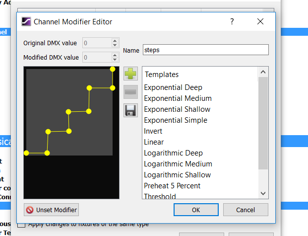

Finally found.
The problem was the PAN FINE and TILT FINE on my 4 moving head. QLC flood too many messages and every configuration of frequency soon or late will break my usb Key cheap.
Use only TILT and PAN is not very beautifull to see if movements are slow, but I found a solution that can be a compromise.
on channel fade configuration, for pan fine and tilt fine, create a step curve (I attach the printscreen). This will filter some packets. After this my usb key never restert anymore.
People that buy a cheap usb key udmx like me my advice is to use
- Update the driver windows udmx (I found this one, just try: https://www.illutzmination.de/udmxdriver.html?&L=1)
- Use the gateway : "Art-Net to DMX.exe" located on freestyler installation and use QLC that point to artnet.
- Use steps on pan fine and tilt fine
With this configuration it work very well al 50 hertz, no problem with latency or something else. I will give a feedback of stability and realibility
my usb key is this
https://it.aliexpress.com/item/2016-New ... 0.0.tlEP3N
Bye

- Posts: 4483
OR untick Pan/Tilt "can fade" in channels configuration ?

Better tricks. It was very difficult to link this very nice feature with problems with communication problem
Massimo, you did a great job.
