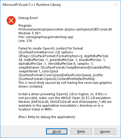

I've compiled bare-bone qlcplus-qml (no plugins) using Visual Studio 2017 and Qt 5.10.1 64bit, and it works on my computer (using sw rendering libEGL,libGLESv2 and d3dcompiler_47).
3D view doesn't crash, just shows info about unsupported OpenGL.
Without libEGL etc. it produces this warning and the program stops. The text is somewhat similar to what I've seen in the debugger.
I still can't run the msys version (that may be caused by my other msys installation...)

Thanks for this test.
Then my suspicion is getting real: Windows Qt builds with desktop opengl don't work everywhere.
I remember seeing comments in the Qt5 PKGINFO file on MSYS2 about trying to use ANGLE, but I think it was unsuccessful.
So basically adding those 3 DLLs in the QLC+ 5 folder make it work ?

Those 3 dlls make it work for MSVC2017 build. I tried to copy the ones from mingw53_32 to QLC+_5.0.0_alpha3-TEST-20180425.exe but that didn't help.
I suspected that msys provides their own QT build so I didn't investigate further.
I somehow assume that QT uses OpenGL even in 2D to speed up/simplify drawing the GUI etc., especially with QML...

It would be interesting to see if official MINGW builds suffer from the same issue.janosvitok wrote: ↑Fri Apr 27, 2018 1:51 pm Those 3 dlls make it work for MSVC2017 build. I tried to copy the ones from mingw53_32 to QLC+_5.0.0_alpha3-TEST-20180425.exe but that didn't help.
It does, but QLC+ delivers my own Qt build. I build Qt without ICU, cause it would have meant extra 30mb of useless DLLs.janosvitok wrote: ↑Fri Apr 27, 2018 1:51 pm I suspected that msys provides their own QT build so I didn't investigate further.
Apart for that, I basically build with the same flags of MSYS2.
It does. In fact SG stands for Scene Graph, which is OpenGL based.janosvitok wrote: ↑Fri Apr 27, 2018 1:51 pm I somehow assume that QT uses OpenGL even in 2D to speed up/simplify drawing the GUI etc., especially with QML...
