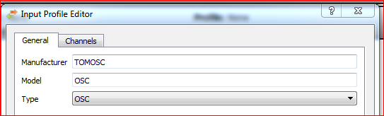

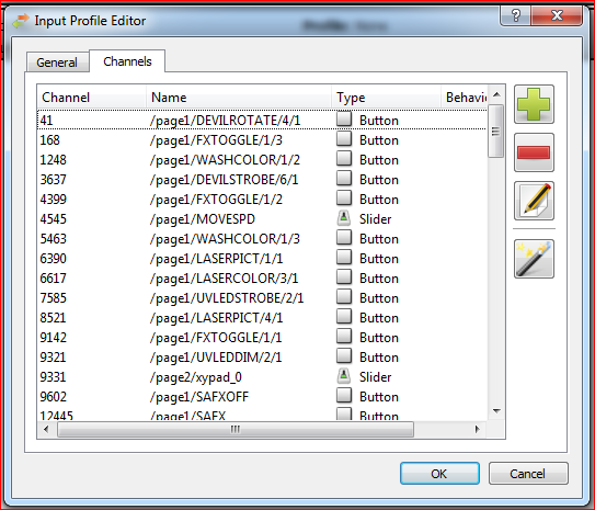

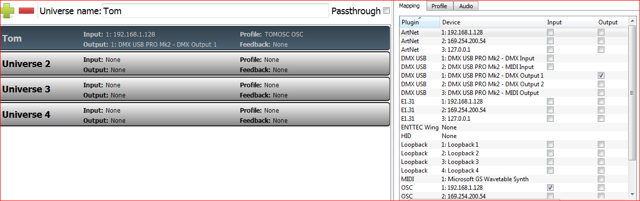

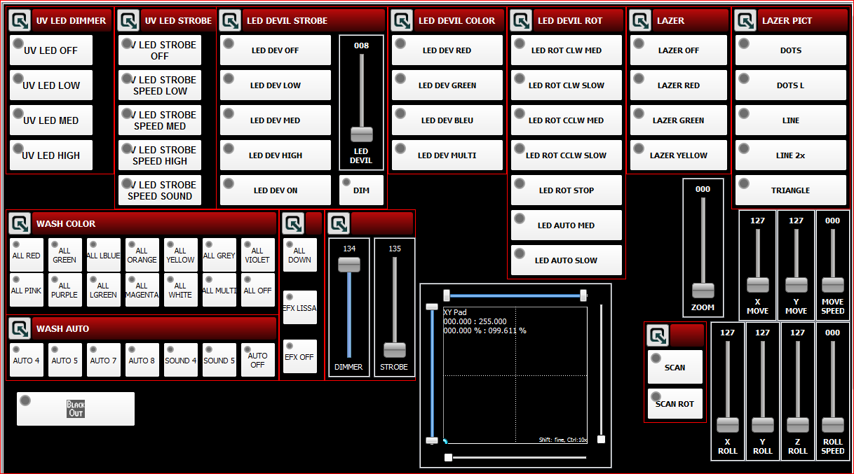

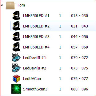

Doing nothing special... I attached some screenshots of the setup.
Just playing around and then for now obvious reason, the TouchOCS (still gives output - blinking green led) is not read anymore by QLC...
It is 'what ought to be' random, I cannot think about a fixture or scene or whatever that causes the halt.
As suggested in this post, switching to and back from 127.0.0.1 reconnects the TouchOCS
