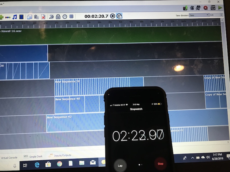

So... the problem returned. I'm not sure why. Just opened the laptop, opened QLC+ and it wasn't keeping time anymore. Here's everything I've tested so far:
Standard stuff: rebooting, shutting down, pulling power and restarting the whole system, running the program as an administrator.
Then I started into looking exactly what was causing the apparently linear slow down, so armed with my stop watch, I ran some scenarios:
1) A brand new show with nothing on the timeline. Added a wav file. Hit play. Slowed down
2) Replaced the wav with an mp3 on the original file. Slowed down.
3) Removed the wav file from the original file. Kept normal time.
Playing any audio file seems to be slowing down the program's internal clock, regardless of what else is on the timeline.
Any advice on what to pursue next to fix this?

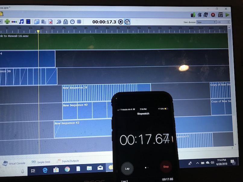

Ok, here's something I think will help with that.
I opened a new file, setup two lights, imported a new wav. I added one sequence right at the end on the last word of the song.
When the singing says "blues" the two lights should turn blue.
Here's a link to three small videos showing the timing issue: https://ln.sync.com/dl/68698c510/k6q74s ... u-2bw37id2
I play the show from the show panel from right before the moment and it's more or less synced. When I play the show from the beginning, you can see it's 1)clearly behind and 2)not keeping up with the waveform of the audio file displayed on the timeline.
The additional test I did was dropping a video instead of an audio file on the timeline. The video file did appear to stay in sync and not lag the timeline.
So I added an audio file back in. Still in sync. At this point I'm wondering if I fixed the problem, just by playing the video somehow.
I open my original file, and no. The show is not syncing the audio with the light. I delete the audio file and add it to a lower track. (Maybe which track it's on matters?) Still not syncing.
So, I have a crazy idea. I throw a video on the timeline and voila, the audio from the original file is now in sync with the lights, even if additional audio is playing from the video.
I now have a work around. I can just add the song as a video (which was part of my plan anyway). For some reason, the video is acting as a stabilizing force on the timecode. But here's where it gets weird. I delete the video, and the song still plays in sync.
This is getting strange, so I see if I can do it again. I close the program without saving. I reopen it. The show plays out of sync from the Virtual Console. I go the show and drop a video on the last track. I then delete the video without playing the show. I go back to the VC and press the button. In sync.
So I press play on the other show, which I haven't touched, but has had the same issue. Also, plays in sync.
For some reason, having QLC+ play a video fixes the timecode delay, even for shows that haven't played the video, and somehow this is stored in the file itself, because I closed the program once again, and reopened it without saving. When I reopened QLC+, it was out of sync again, so I did fix where I dropped a video on the timeline, then deleted it. Then I saved the file, closed it, shut down the program, reopened the program, opened the file, and it's working perfectly.
All of that to say, it's a very strange bug, but I do have a work around for it now.
TL;DR - If you're having sync issues between audio and lights, try dropping a video on the timeline, then deleting it.
