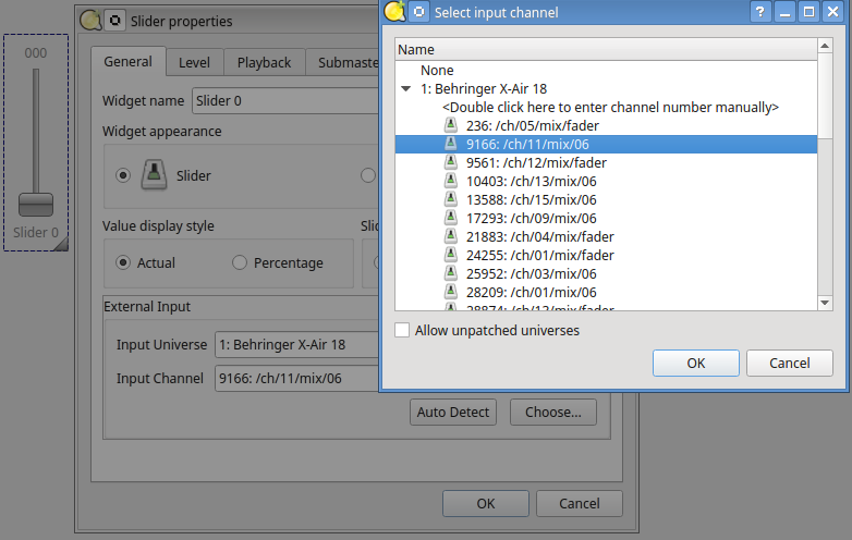

And here's the profile !
I've added all 16 channels, either /.../mix/06 and /.../mix/fader. Also /rtn/aux is there.
Don't know what mix/06 means, but if you used it then I guess it's some sort of level control.
Please note that, at the moment, the QLC+ OSC plugin can only send float values, so there's no chance to have the integer mute/unmute commands that you sent me. I guess you can mute/unmute by setting a level to 0 or not 0.
Now, what are profiles useful for ?

Please test the attached profile and let me know if it works.
Set the OSC plugin as input + feedback, with the X-Air IP address in the input line.
As I have written in the documentation:
Note: When patching a Input+Feedback line, the output IP/port you need to change are the ones in the 'Inputs' section. Just leave the 'Outputs' section as default.
In theory with a virtual console slider you should be able to control the level of one of the mixer's channels !
You will have to select the input channel of the VC slider manually, using my profile.

I tried it but I didn't have any luck. I've not set this up before so I'm probably doing something wrong so maybe you can walk me through a few things. As far as the inputs, it seems as if those are automatically filled with the IP address(es) of the machine that QLC+ is running on. Am I missing something? Because I'm only able to change the output IP address. I did try setting the output IP address to the IP address of the X-Air but still, I got nothing.mcallegari wrote: Please test the attached profile and let me know if it works.
Also, just to make sure I'm doing this correctly, should I just be setting up a fader and selecting the correct output channel? It's not necessary to have anything set for the actual function of the fader, is it?
Finally, I did want to just make one comment which, I think I've made elsewhere, but it is probably more relevant here (but don't get me wrong, I think that if we can get this working it will be a great first step) but it seems to me that it would be really nice if QLC+ could send arbitrary OSC/MIDI/etc. commands in the same way as it sends DMX. I'm thinking like scenes but for MIDI/OSC. From what I understand this is somewhat possible now, but it seems that it's not as flexible as it could be. For example, I have this little Behringer CMD-DC1 Controller that I use with QLC+ and while it works fine, it requires that a specific value be fed back to the controller to get the buttons to blink or change color (to indicate an active state, for example). That's difficult, if not impossible, to do with QLC+ alone (I'm working on using MIDI Pipe or something like that to achieve that in the meantime). Just my $0.02.
In any case, let me know and I'll see if I can make it work.

Here's a screenshot of where you need to put the X-Air IP.gmint wrote:I tried it but I didn't have any luck. I've not set this up before so I'm probably doing something wrong so maybe you can walk me through a few things. As far as the inputs, it seems as if those are automatically filled with the IP address(es) of the machine that QLC+ is running on. Am I missing something? Because I'm only able to change the output IP address. I did try setting the output IP address to the IP address of the X-Air but still, I got nothing.
Also you need to know the port where the X-Air receives OSC data. [EDIT] The output port to set should be 10024
Obviously your computer must be in the same network of the X-Air
Yes. Here's another screenshot.gmint wrote:Also, just to make sure I'm doing this correctly, should I just be setting up a fader and selecting the correct output channel? It's not necessary to have anything set for the actual function of the fader, is it?
Create a slider, open the configuration dialog, click on "Choose" and select a X-Air channel. Leave all the rest to default.
