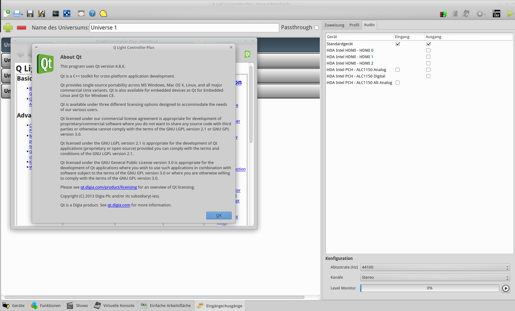

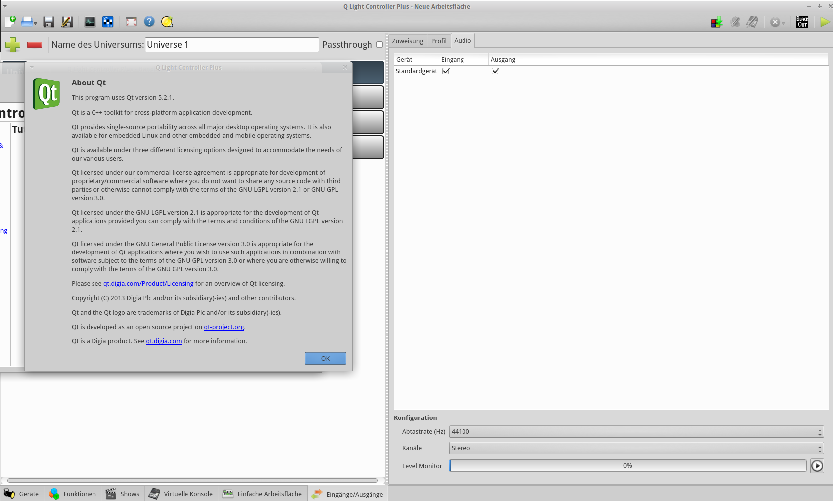

Please show us a screenshot of the devices list with the Qt4 version and the Qt5 version.
By the way, which Qt5 build are you using ? One of the automated builds ?
siegmund
Posts: 703
Joined: Mon Nov 02, 2015 11:03 am
Location: Germany
Real Name: Lukas
mcallegari wrote:Please show us a screenshot of the devices list with the Qt4 version and the Qt5 version.
Find some screenshots in the attachment!
mcallegari wrote:By the way, which Qt5 build are you using ? One of the automated builds ?
Yes, the automated build for Linux Ubuntu - could that be a problem?
Please note that I'm experiencing this issue with the latest Qt4/5-GIT (automated)builds, too.
Could anybody please mention some steps to locate the problem? I'm running out of ideas...

Might be that your Qt5 instalallation is incomplete.
QtMultimedia uses a few plugins as backends to the actual sound system (might be ALSA, PulseAudio, etc)
Probably the package you're looking for is: libqt5multimedia5-plugins
siegmund
Posts: 703
Location: Germany
Real Name: Lukas
mcallegari wrote:Might be that your Qt5 instalallation is incomplete.
THANKS A LOT!
Exactly what I was looking for!
This also provides a "monitor" device so I don't need any loopback..
Love this software! :geek:
Thanks for your help!
