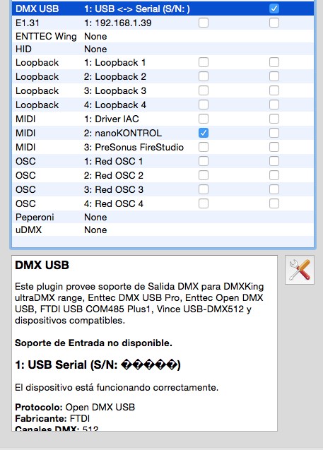

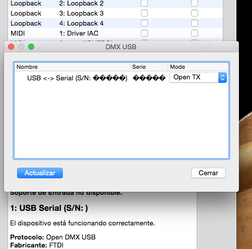

- Posts: 4933
Did you install any other software that could take control of the USB-Serial ports ?ssscubells wrote:In the input/output section, in the description of the selected item it shows a weird seria number for the open dmx usb dongle (kind of strange symbols instead of letters and numbers).
When you see weird characters in the serial number, it means there's some wrong driver acting on the USB port (VCP drivers?)
I have OSX 10.10.2 and all I did was to disable the crappy Apple FTDI driver and reboot. No other software installed.

I've tried uninstalling vcp drivers as found on the FTDI installing guide for Mac Os, but in Terminal it appears as it doesn't exist.
I attach some images of the weird serial number. I can try uninstalling the other lighting control software on the computer to check incompatibilities but I'll have to wait a couple of days because I have performaces on this week.
Thanks
Oscar
