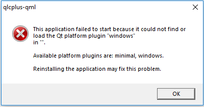

Same issue. https://ibb.co/cVZtNn

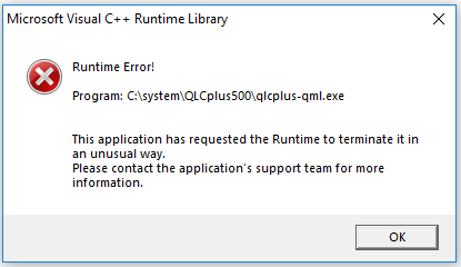

Now I'm having troubles also...
Failed to run with these 2 messages ... trying to find a solution online I came with this best shot?

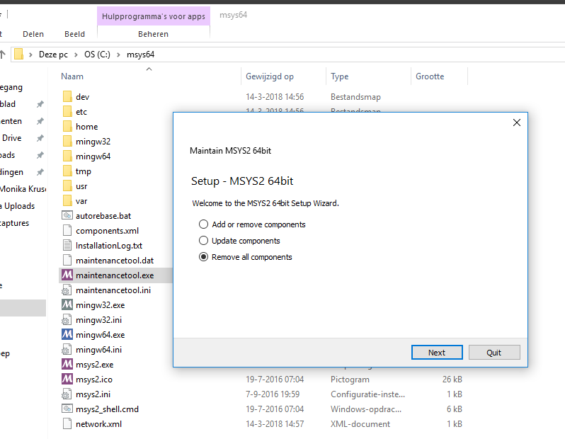

For those who
* use windows
* have ever installed MSYS2 (MSYS or MINGW...)
! (check existence of msys, msys2 or mingw directory)
Please uninstall using <administrative rights> !! The registry has to be altered
In my case I had
*MSYS64 installed
*inside c:\msys64
to uninstall MSYS2
use the
*c:\msys64\maintenancetool.exe WITH administrator rights ... (hint: if it doesn't do anything ... I told ya <admin rights>) feedback of success:

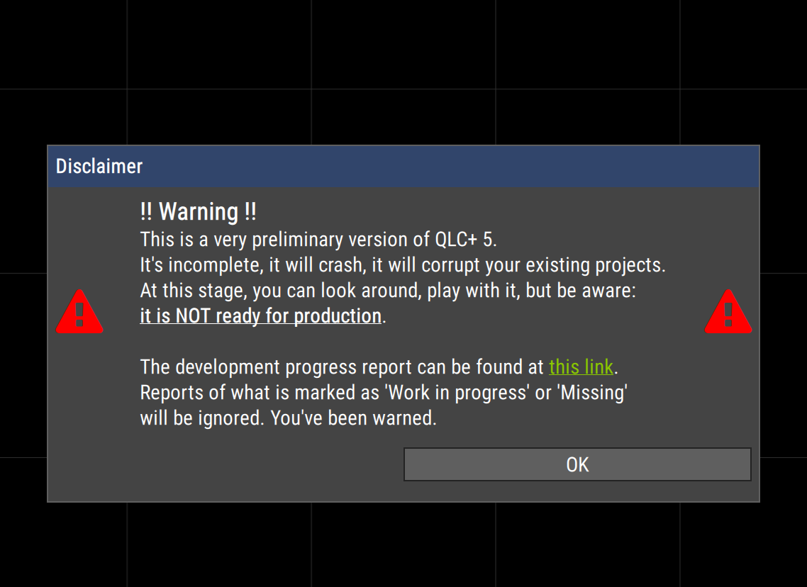

The programs runs, and I get the warning splash screen.
