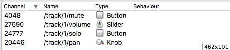

OSC channels:
The channel number is a number (unless you want to know specifics, let's say arbitrary) assigned to the OSC path. Since QLC+ internally doesn't distinguish
where does the input signal come from, and works with DMX channels and values, we need to have a way to map OSC paths to DMX channels (though as you see,
it's been a bit extended, the number may be larger than 512).
You don't want and don't need to know how is it computed (if you are curious, the code is here: https://github.com/mcallegari/qlcplus/b ... r.cpp#L225).
You just enable the learn function and let QLC+ compute it as the linked post says.

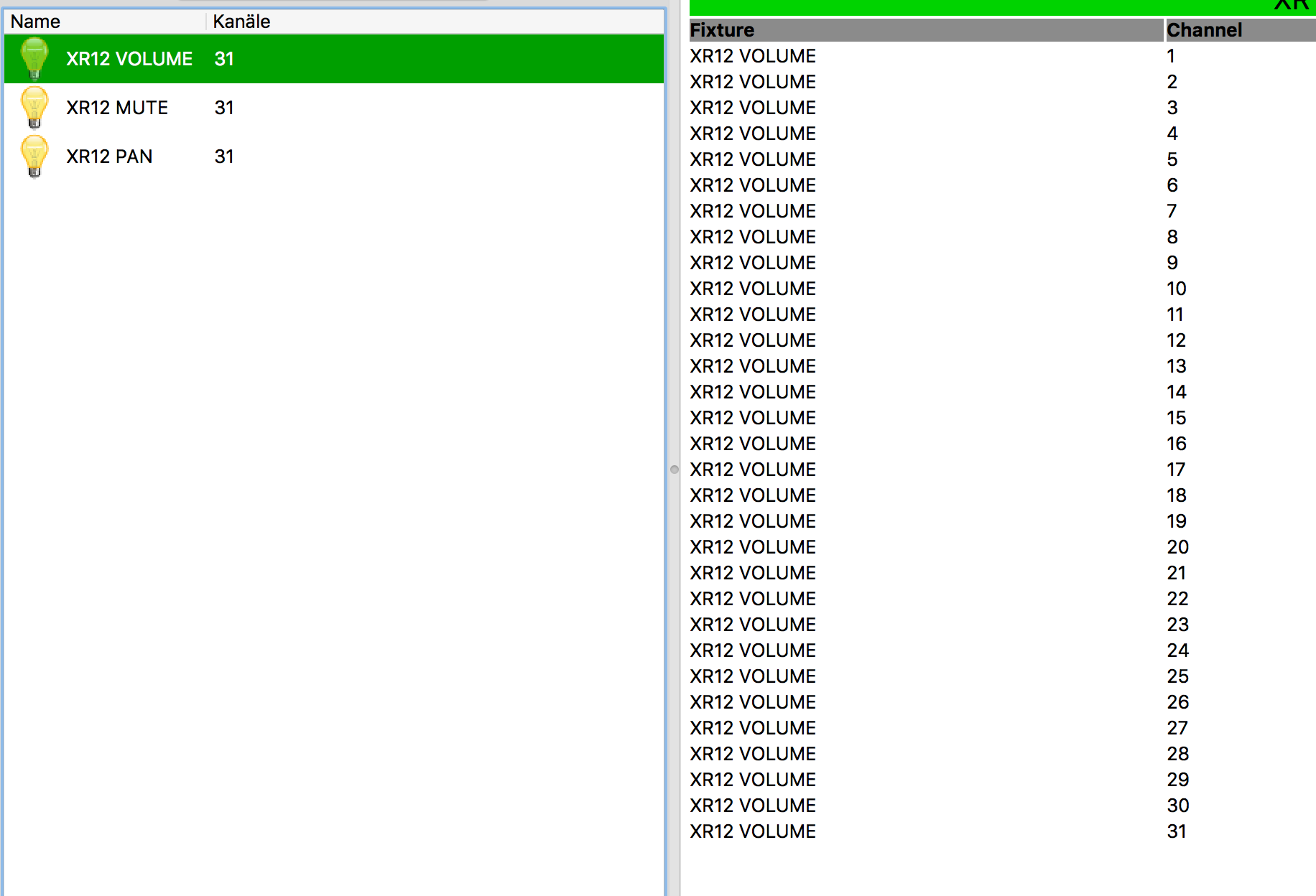

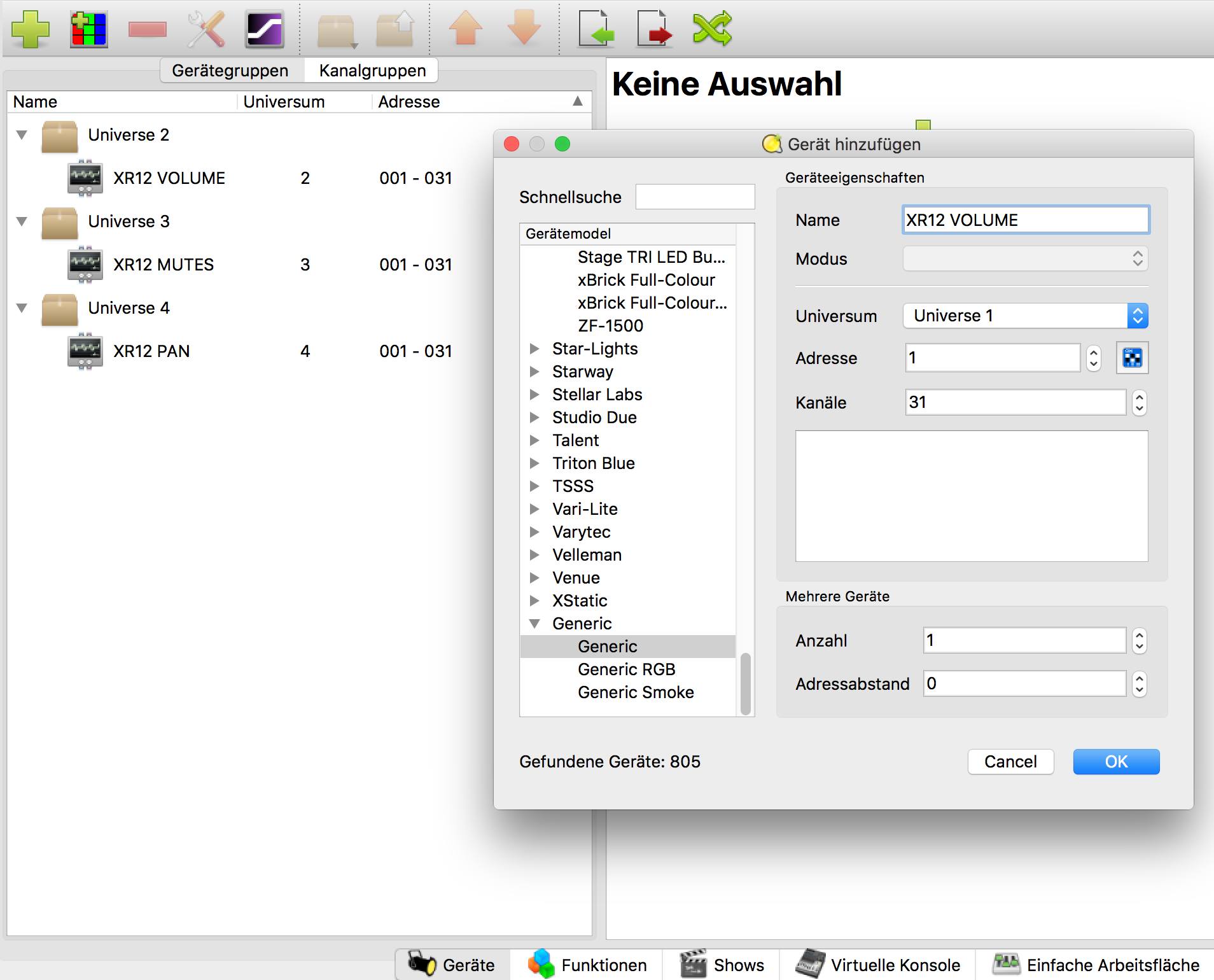

Solution A: Automation / Simple Desk View MIDI-Control of the Behringer X-Airs for QLC+
Note: with this settings you can use the Behringer just like a fixture and programm volume fades into the scenes!
But: You can either control the volume OR mutes OR Panorama with one midi-device. If you want to control more, you need extra midi-devices or maybe configure all in the same universe with following adresses (1-31, 32-62...) and if possible route 1-31 to midi channel one, 32-62 to midi channel 2, and the rest to channel 3.
1: Create a new fixture(s). Use "generic" -> "generic" i named it XR12 VOLUME, Adress 1, Channels 31 (more for the XR18...)
2: Create channel group(s) 3: Select your midi-output device for the universe you created the fixture in. Double click on the midi-device and select channel 1 for Volume-Control, Channel 2 for Mutes, Channel 3 for Panorama Control. Set mode to Control Change
yes there is a midi-solution (you have to adjust channel count for the xr18 because i only have the xr12 but this should be easy)
For your request see my next post with Solution B viewtopic.php?f=5&t=8983&p=46513#p46514

I have a basic working channel strip that controls mute, level, solo, and pan. (See attached)
I still don't know what I'm doing when it comes to QLC+ but I've followed some old instructions from @gmint that told me to create a dummy fixture and dummy scene for each widget.
I've also attached the input profile for the X-Air channel strip so you can see the OSC messages. Remember I'm not talking directly to the X-Air mixer but to a program called XAirRemote which does the to/from translation.
Also, I think i found a bug in the OSC input handling for buttons but I need to do some more testing before I know for sure.
Finally, I can't seem to figure out how to get the pan knob any bigger. I have to make the widget huge just to get a usable size knob.
--Ken
--Ken

That is absolutely right.kenm wrote:I still don't know what I'm doing when it comes to QLC+ but I've followed some old instructions from @gmint that told me to create a dummy fixture and dummy scene for each widget.
This is normal. You cannot size the encoder itself, you have to enlarge the whole knob widget.kenm wrote:Finally, I can't seem to figure out how to get the pan knob any bigger. I have to make the widget huge just to get a usable size knob.

Hi ken, looks great - where to find this programm XAirRemote? No google results...kenm wrote:I've also attached the input profile for the X-Air channel strip so you can see the OSC messages. Remember I'm not talking directly to the X-Air mixer but to a program called XAirRemote which does the to/from translation.
Anything special to set up? Qlc Input/output channels?
Also can you make a Screenshot of the fixture / scene /any settings ?
Since it is a fixture, can you also use it outside the virtual console? Programm solo/mute/volume into scenes/shows?
How reliable is the Osc connection with your setup?
Many questions, really interested in this thing
Thanks a lot

Hi Christoph,
XAirRemote is still very new so it probably isn't in any search results. I had to make a change to the program to support the way QLC+ handles OSC inputs so as soon as I get that change tested I'll build some binary packages and post the links. The program will also be open-sourced so you can view the code to see how it functions. It takes less than 5 minutes to create a configuration file and get the program up and running.
Also, since I'm very new to QLC+ I can only provide a simple explanation of what I have working. Right now I'm using a dummy fixture (generic dimmer) controlled by one dummy scene per widget. I've created an Input Profile that defines all of the possible OSC messages for XAirRemote. The OSC plugin is set to Input + Feedback with its settings matching the configuration settings of XAirRemote and the Input Profile selected. What I need to do now is go read about the Fixture Definition Editor to see if I can create a fixture to define an XAir channel strip. Please allow me a few days to figure this part out and build a well-documented sample setup.
As far as reliability goes I ran 17 theater performances in December with TouchOSC and Lemur controlling an XAir XR18 using XAirRemote. I know of a 5 member band who's using XAirRemote with an XR18 to control individual monitor mixes + FOH Mains and they haven't had any problems.
What operating system are you running? PM me and I'll send you a binary and some instructions to get it setup.
--Ken
